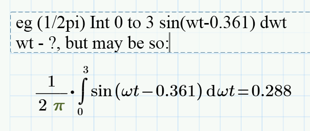

I am trying to set up the following definite Integral in MathCad as a function of wt, not just t, how would I do that.
eg (1/2pi) Int 0 to 3 sin(wt-0.361) dwt.
Thanks in advance.
Vijay

Thanks Valery,
I have MathCad 15, also wt = 2*pi*60.*t
Will this work in MathCad 15.
Vijay

Vijay Khatri wrote:
Thanks Valery,
I Will this work in MathCad 15.
Vijay
Try pls
