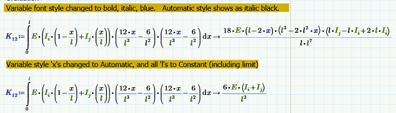

Mark Gase wrote:
Could the problem have to do with the labels in Prime (i.e., are all x's labeled as variables)?
Here is the result from v15:
Good call, Mark.
Stuart

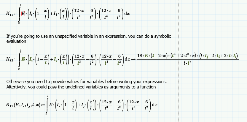

Ramani Ayakannu wrote:
Can anyone help me evaluate this integral?
Is this of any help?
Stuart
rayakannu1-VisitorAuthor
The problem s the symbolic solution still has the variable . The solution should be only in terms of Ii, Ij, and l
I should have rephrased the question.
I did the symbolic evaluation, and got the same answer as yours, but the solution still contains the variable x. This should not be the case for a definite integral.
