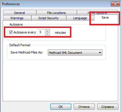

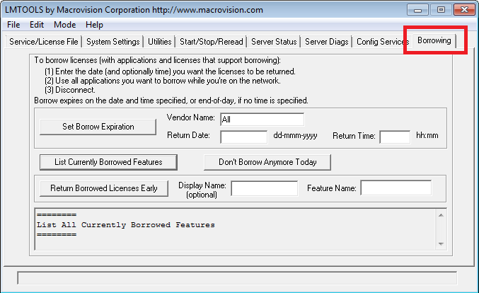

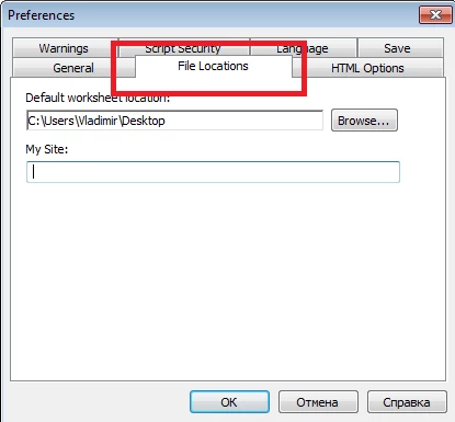

Mar 2, 2017 12:47 PM UTC
Hi Jeff,
Never seen this issue. Users use the "floating" type of license (if so check "Borrowing" settings in the license server)? Because under certain settings the license can return to the server.
They use the "Autosave" option (with the correct location of the file)?

No license borrowing.  We have firmly tethered desktop machines.  License isn't dropping.   However, even if the license dropped, a message would pop up warning that the currently loaded files should be saved to disk.  This isn't happening.Mathcad is running properly and it "looks" like it is saving the file properly, but it's not actually updating the file.
Autosave is up to the users, but it has caused problems in the past so I believe most users run with it off.  I may have this user change his current autosave state and see if it helps.
