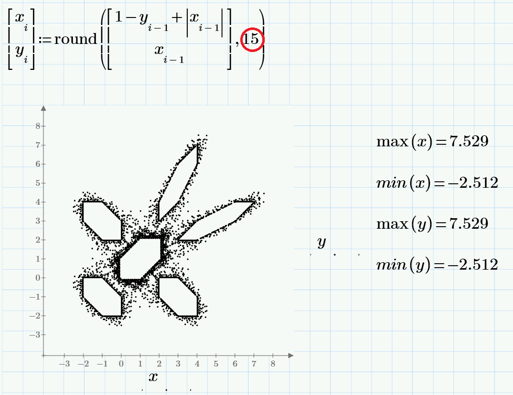

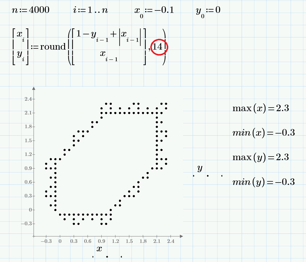

Aug 27, 2014 5:20 AM UTC
One Mathcad Calculation
(more http://mathworld.wolfram.com/GingerbreadmanMap.html)
http://twt.mpei.ac.ru/ochkov/Sovet_MC/238/238_Round_Error.gif
