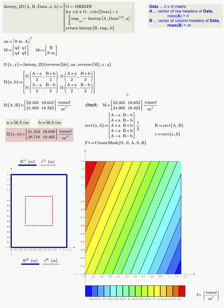

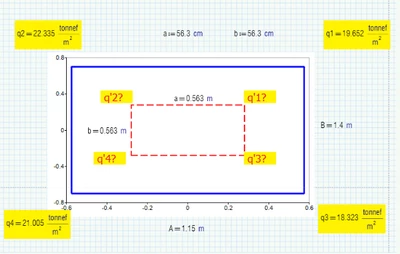

Good afternoon friends of the community, I am new to using Mathcad. I have a problem getting data from a general graph for an area smaller than the interior as shown in the graph. My version of Mathcad Prime is V.9.0
Thank you for your attention.

I don't speak Spanish and (like you) I am too lazy to fire up a translator.
But in case you are looking for interpolation as you had written in the thread subject, you could do it that way:

Its not clear to me what exactly you are looking for.
Are you just interested in the very same calculation but with different input values A and B?
If yes, you may consider turning the calculations into functions with arguments A and B.

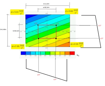

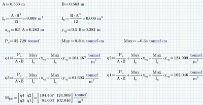

Good morning, the problem I have is that the new values ​​obtained with "a" and "b" are greater than the values ​​found in the corners of the larger rectangle. What I want to do is obtain the values ​​at the points considering the values ​​of the large rectangle, because 104,467, 124,909, 81,603 and 102,046 tonneph/m are greater than the limits of the rectangle 18,323, 19,652, 22,335 and 21,005 tonneph/m.
