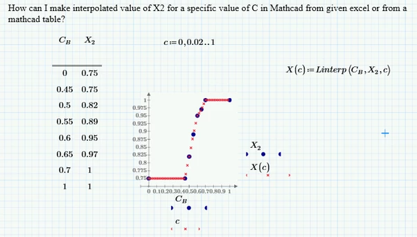

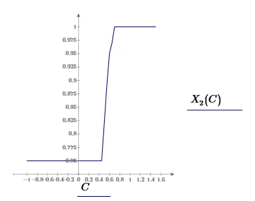

@TudorMarin @Werner_E how can I make interpolated value of X2 for a specific value of C in Mathcad from given excel or from a mathcad table?
PerezAnswer
Jul 12, 2023 3:09 PM UTC
The propose solution below should work for you. It keeps the original data as is without adding extra rows. For any value less than or equal to 0.45, the value of X2 should be 0.75 and for any value equal or more than 0.7, the value of X2 should be 1:

The function is Linterp!
8-Gravel
Jul 12, 2023 12:06 PM UTC
thank you for suggesting that function, but what if i have to get only value of 0.75, for value any less than 0.45 of CB and similarly to get value of 1.0 for X2 for any value of CB more than 0.7
23-Emerald V
Jul 12, 2023 12:20 PM UTC
Linterp will extrapolate from the last two points. That's what Fred shows. If you add 0.75 for 0.4 (or 0) of CB, and 1 for 0.75 (or 1) of CB you should get your straight horizontal lines.
