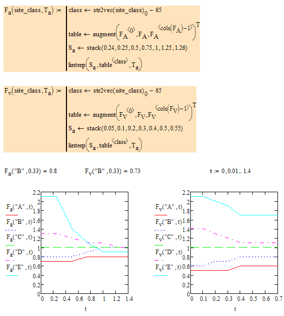

Would anybody please help me with the attached file. My goal is to do interpolation given a period T.a =0.5*sec, based on site_class and the header Sa(0.2*s)  for Fa(site_class, Sa(Ta)) and
same for Fv(site_clas,Sa(Ta)), I'm having problem as to how to program this in Mathcad. I will appreciate this if anyone can help.

If linear interpolation is sufficient, I guess that the attached should do the job. Just a quick hack - no error checking for invalid site_class is implemented and ORIGIN=0 is assumed.

Please see attached pdf file. On the subject on earthquake, the values generated  for Fa and Fv seems to be off and I do not know why. Would you be kind to review the Mathcad function linterp.

The equations Werner provided to you calculate:
  • Fa as a function of site class and Sa(0.2)
  • Fv as a function of site class and Sa(1.0)
They are not functions of Ta as seems to be indicated.
Therefore, his equations appear to match the values shown in your attachment:

Thanks for your comment. What should I do to resolve the issue in the function statement.
