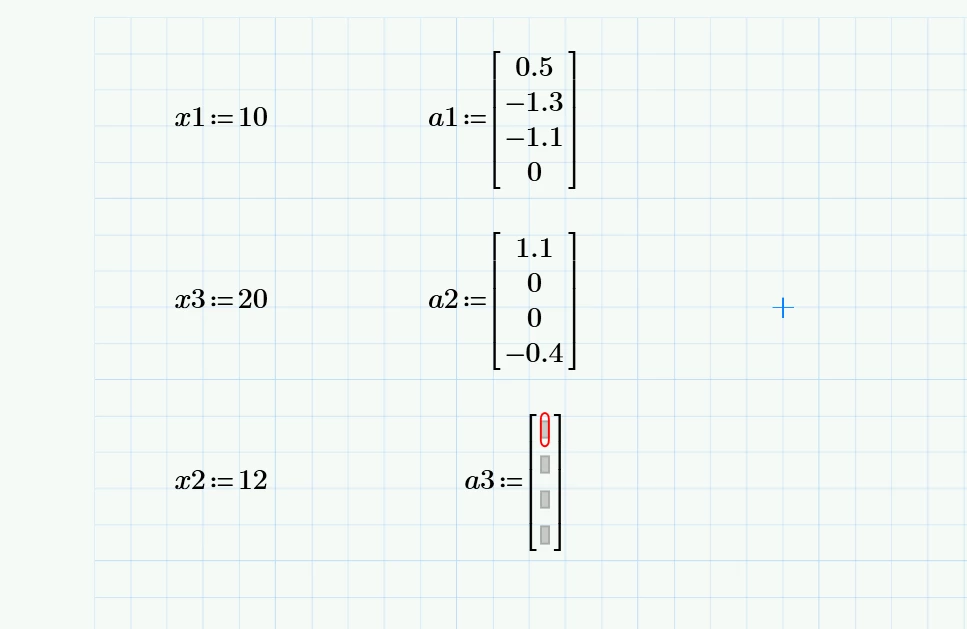

I have a query with interpolation:
We have 2 tables of data X1 and X3 with 4 items for each table (or matrix, vector)
X1 at value of arguments 10
X3 at value of arguments 20
I want to interpolate at 12 of arguments?
Can anyone help me?

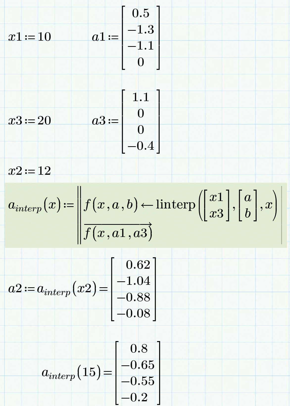

23-Emerald V
Of course Fred's method works.
But you shouldn't need to define the interpolation function, just use linterp(), which is built-in.
23-Emerald I
DUH!
More coffee!
Here is a variant getting rid of the range variable and using a function with vectorization:
