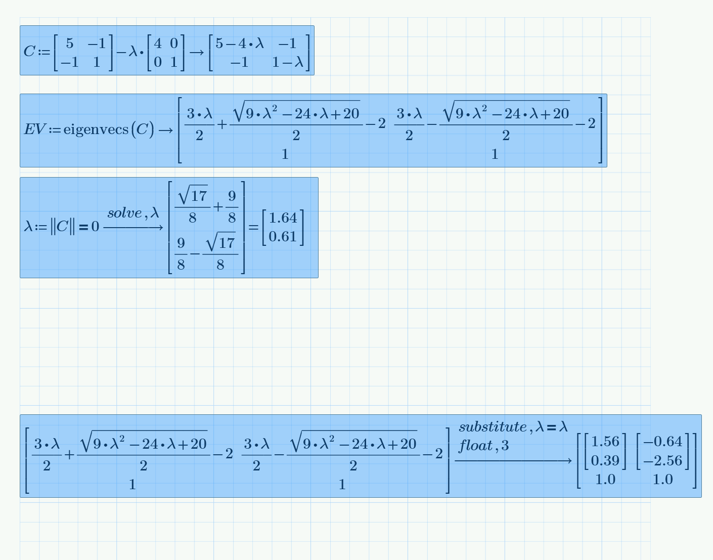

Hi, everyone
Here I am trying to find the eigenvectors of C using the function eigenvecs,
I know eigenvecs returns to all the eigenvectors of C,
My hand calculation shows the two eigenvectors corresponding to the two eigenvalues should be
[0.39;1] and [-0.64;1],
So what does [1.56;1] and [-2.56;1] represent?
Thank you very much!
Shawn
November 12, 2015
In your last expression you have a square root, which has two possible solutions (+ or -). Mathcad is showing you the two solutions.
Edit: Also see my comment about the use of the float keyword in this thread (near the end): incompatible units - PTC Community
sfan1-VisitorAuthor
November 12, 2015
Then for the eigenvectors, which pair should I use?
How to verify the ones that correspond to my hand calculation?
November 12, 2015
Well, that's the tricky thing about square roots. There is a common misconception that sqrt(x) has two solutions. It doesn't. It has two possible solutions. Absent any other information, you can only know that one of those solutions is the correct, one, but you can't know which. So what to do? One possibility is to find other information that resolves the dilemma. Another is to reformulate the problem to avoid the square root. In this particular case I'll make the observation that the way you solved for the eigenvectors by hand is not the same as the way you had Mathcad solve for them
