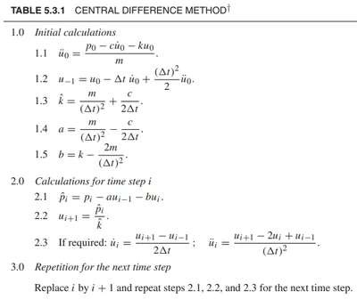

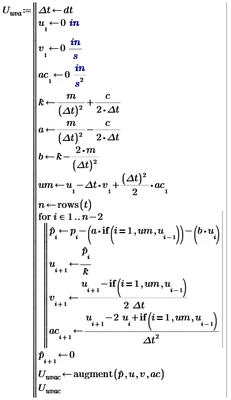

I am trying to program the following with some tweaks to fit my problem.
I am pretty new to MathCad Prime and I am running into some problems with verifying my array index in step 2.1.
Please help!
Thanks!

See if this helps:

See if this helps:

Thank you!
