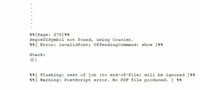

Hello everyone,
When I start the print preview of a Mathcad 15 worksheet and I try to print it in pdf format, I receive this message:
Is it possible to determine the character that generates the error and the non-production of the pdf file?
This problem has happened to me on other occasions in the past. I ran the search excluding parts of the worksheet at each Print Preview. But it takes too much time and luck. I am looking for a faster way.
Thank you very much.

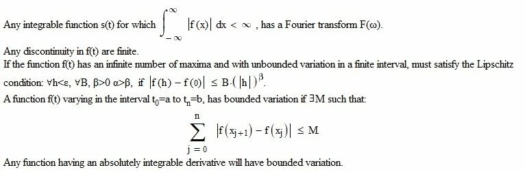

I finally found where the problem lies: it is made up of several lines of text with formulas inserted. What is the source of the non-production of the pdf file? I attach the file (it is a part of an appendix):
You can find it attached:

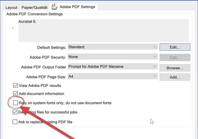

Try unchecking "Rely on system fonts only" in the settings of the AdobePDF printer

Out of idle curiosity, does the attached xmcd file open in your version of Mathcad?  If so, does it have the same problem as you're currently seeing?
Stuart
-MFra-
-MFra-21-Topaz IIAuthor
It is a file created with Mathcad 15 and has the same problem as the original file. The problem is just a few fonts.
23-Emerald V
OK, thanks.  I'd just removed 3 rendering tags - I wondered if they had something to do with your problem.   I do note, however, that you have a mix of Times Roman, Arial and Courier fonts.   What happens if you change the Courier font to Times Roman?

Werner_E25-Diamond IAnswer
