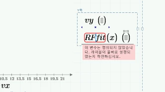

I definitely defined f(x,beta), but when I try to draw a diagram, the following error occurs.
How can I solve this problem?
Inside the red box, "This variable is not defined. Make sure the label is set correctly."

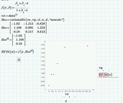

Move your plot under the definition of RFfit(x).

Here is my worksheet. thank you!

Thank you so much..!!
