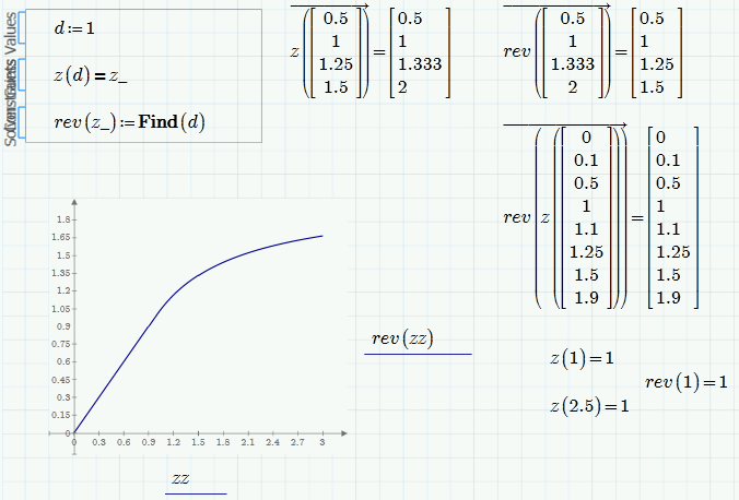

Mathcad won't be able to provide a symbolic solution because it cannot decide on the different branches of min, max or an if statement with a variable, symbolic argument
For a numeric solution you may use a simple solve block. In the example you provided it works OK var values of d up to 2. z(d)=1 for d>2, so z is not bijective outside the interval you have chosen and so the inverse can't works. rev(z) would yield 1 for z=1.
In your final application one problem could be that a single, constant guess value for d (in my sheet I had chosen d=1) does not work for the whole range of z-values provided. But we'll deal with this issue when we get to it.

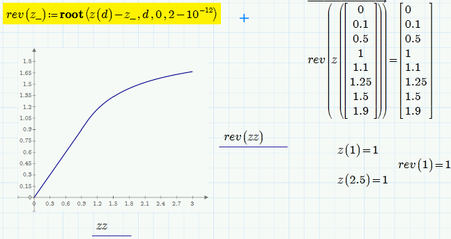

No problem. If you stay with d in the range [0;2[ you would also not need the max() function either as 1/(2-d) would always be larger than 1 for d>1. But I already guessed that your original problem would be a bit more complex.
EDIT: Here is an alternative approach without the need of a guess value using the root() function:

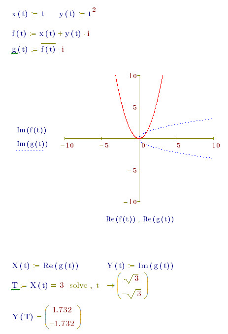

Jan 12, 2015 1:01 AM UTC
Mine Solution:
When the function is an even function, Werner's method couldn't work, because root or find only return one root or can't find any root in the guess value range.
Jan 12, 2015 1:21 AM UTC
I guess you haven't looked at Adrien's original function because you have not access to Prime.
Here is a pdf printout so you can try your luck using the symbolics
Keep in mind that we must use the min, max and if statements, as Adrien's original function is more complex and requires that.
Jan 12, 2015 7:57 AM UTC
Oh, sorry, Werner, the solve symbolic calculation really can't solve that function
I haven't install Mathcad Prime, so I haven't read the original article. If use the numerical root or find, my method is the same as yours, and seems more troublesome...
