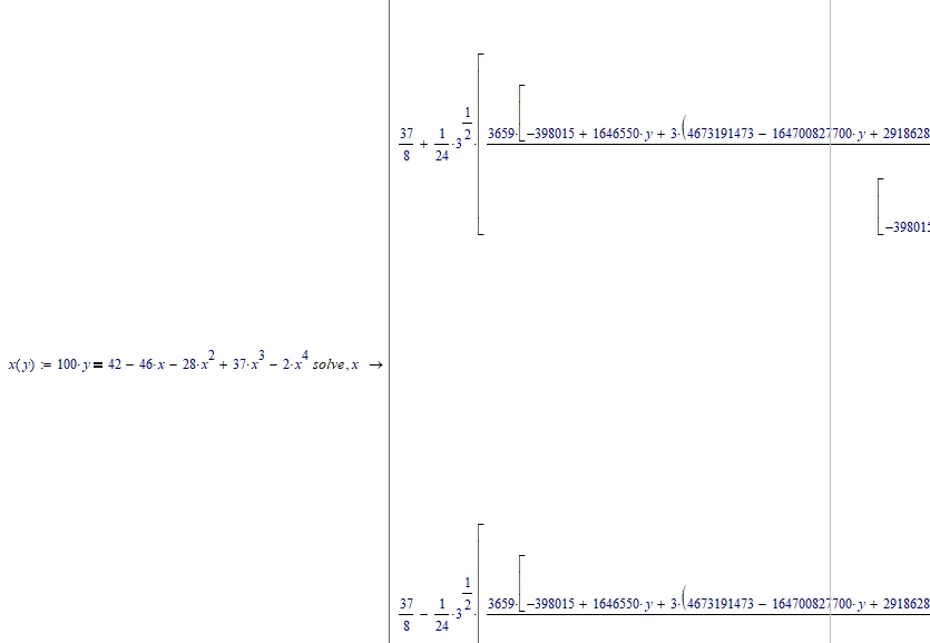

Now to your question.
Since you know the forward function, to get the inverse function you can try to solve for x with known value of y, either symbolically or numerically.
Since it's a 4th order function, you won't like the symbolic solution, if Prime is willing to provide it at all.
(I'm limited to Express Prime = no symbolics) Here's a small part of the results using Mathcad 11:
(Note that:
- I've made sure that all constants are integers, to prevent extremely wide real numbers, by multiplying both sides of the equation with 100.
- This picture shows only a small part of two of the four possible solutions. And most probably only one, or two of the solutions give real answers; the others giving complex answers. )
Another way that even works in Express Prime is to use the root function (look it up in the help!):
(I've set the upper limit for x-values to 11, to assure that all values are found on the defined part of the graph. If you need larger x due to larger y, just increase that value above 11)

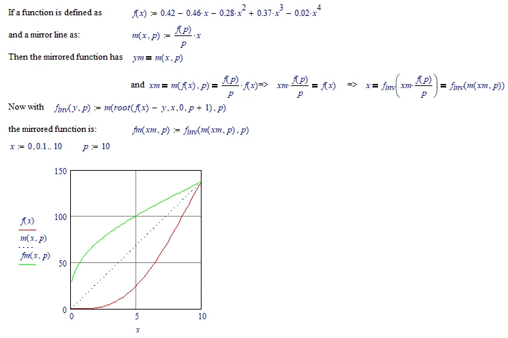

Mabi i explayned myself a bit wrong. I uploaded a new file with a paint picture of how it shud look like. I tryed the inv function and dosent help me, with the thing i want 😞
LucMeekes23-Emerald VAnswer
23-Emerald V
November 29, 2017
Ah, you need a little more than the inverse. You want your function mirrored over a line.
Here's how to do it for a straight line through 0,0:
(I did this in Mathcad, not Prime; you should be able to recreate it in Prime)
There's one extra parameter (p) to the mirror line function m. You can play with that and see how the results change.
