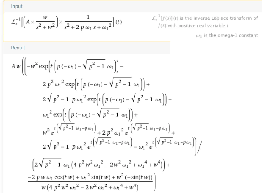

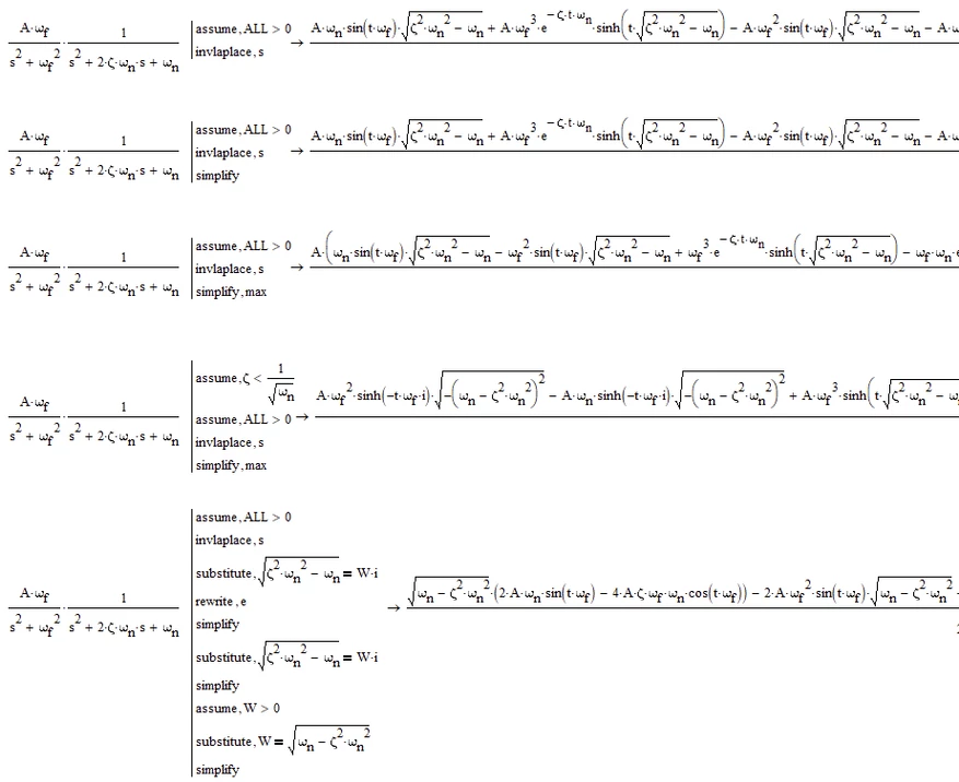

to all,
Attached is a 1st test of using mcad15 inverse Laplace. While I get something, is there a way of getting a “neater” response out of mcad15? For example mcad15 returns sqrt(wf^2) – why not wf ? I think one can end up getting imaginary numbers if one uses specific values !
I know some of the regular users are very handy at using Laplace operations so maybe I might get a few tips and/or tricks
[correction: a square was missing!]
