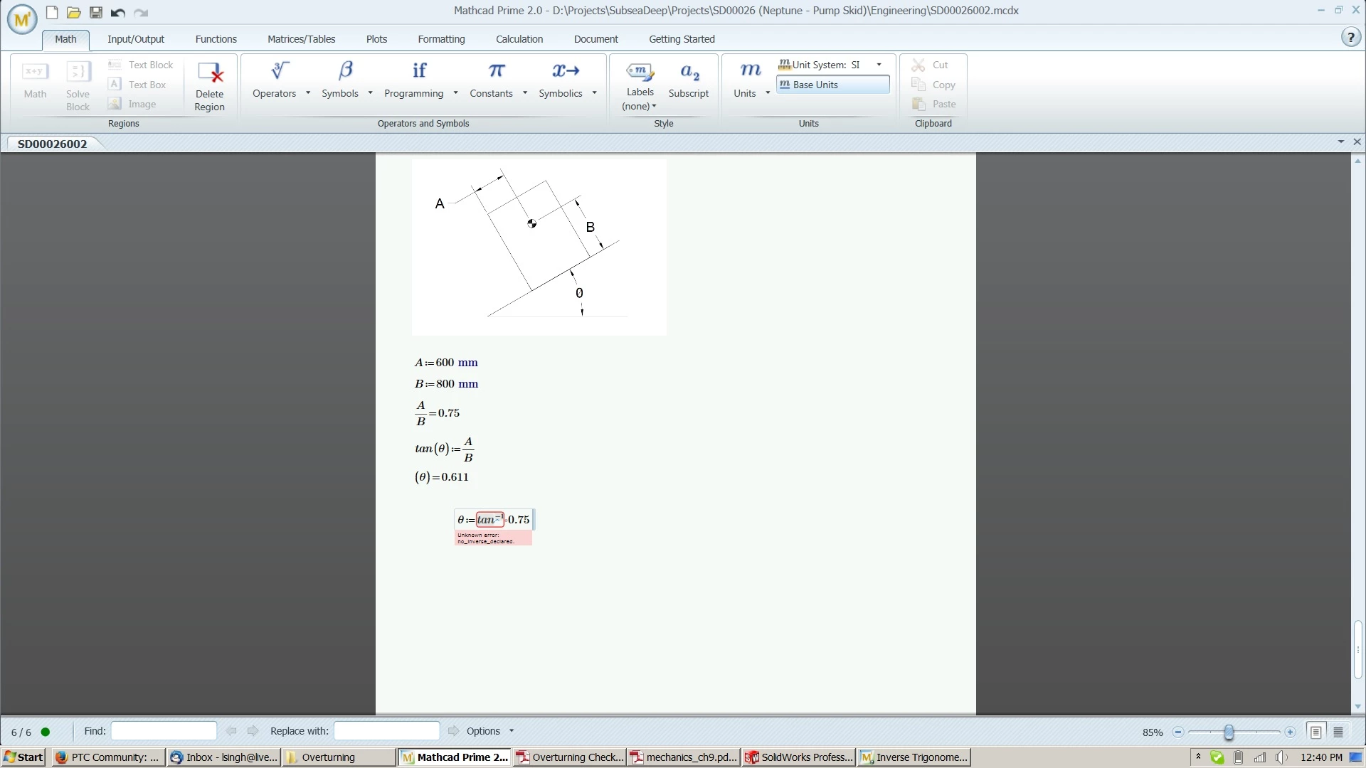

Hi All,
In MathCAD Prime 2 I am trying to write inverse of tan to get the value of theta. Please see attached.
1. I am not getting the right answer (please see file 1). The value of theta should be 36.86.
2. I am not being able to write it (please see file 2).
Can someone please advise how to correct this?

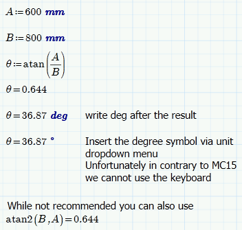

See please the atan function.
September 29, 2013
As alread advised by Valery - use atan(). Thats what arctan() is in my math books and what atan^-1 is on your calculator.
The result will be in radians, to get it in degree simply put the desired unit after the result.

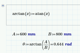

My students do so in Math works with Mathcad:
And the second:
September 29, 2013
The second pic doesn't show and the link is broken.
