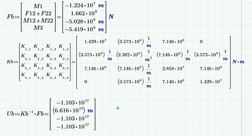

Hello, I am trying to invert a matrix to solve F=K*U in an FEA problem where F and K are known.
On paper this is solved by K^-1*F=U
All the units in K keep their same order of magnitude, which I believe is incorrect.
Multiple online calculators for inversing matrices give several very different answers so I no longer know what to believe.
My final answer for U is around 10^20 orders of magnitude higher that the expected value as shown below.
U values should be a 10^-3*m and 10^-1*rad or less.
I have attached the files as both pdf and mathcad prime express 4.0.
Please let me know what I am doing wrong.

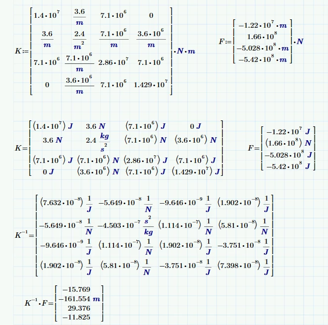

Working in Prime 3.0:
Could you explain what is different in your solution?
It seems like you used the same function on slightly rounded numbers and got a different  very answer.

Your Kb matrix has zero values in the top-right and bottom-left corners. Fred's matrix has all non-zero values.
If I change the 1,5 and 5.1 elements in your K-matrix (the source) from 0 to 0.01 then all elements in the Kb matrix become non-zero and the results kb-1*Fb get into the range of 10^6 instead of 10^17...
I guess it's your data...
