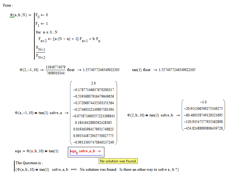

  The Question is : What is Irrational Number for "?"   ?

  Thanks for your time, Alvaro. And I have a relative question :
    Regards.
       Loi.
Obviously too many solution pairs for the symbolics.
You may like to play around with a numeric solve block
