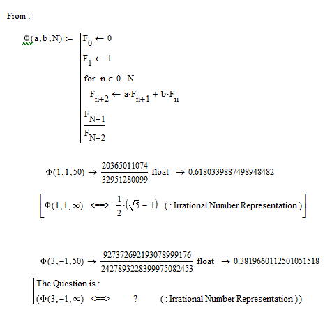

Irrational Number Representation.
  Hello, Everyone.
  The Question is : What is The Irrational Number Representation for " ? "    ?
      Thanks in advance for your time and help.
           Regards.

Many thanks, Luc and Alvaro. Your answer to my question are very clear to me. That's all I wish to know about.

As Alvaro nicely derived, your answer is (3 - sqrt(5))/2.
Here is another approach:
