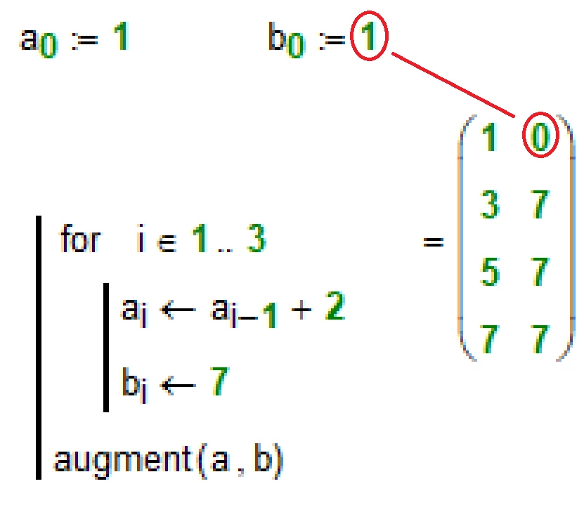

@ValeryOchkov wrote:
Is it an error in Mathcad?

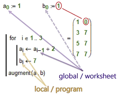

Not at all. Its the behaviour as it should be.
Note that the global b and the local b have nothing to do with each other! The local b is a new variable created by the program and as you don't provide a value for the element with index 0, this element is initialized with 0 as usual.
If you want a global variable to be used in a program you have to either provide it as an argument of your function or you must use it on the right hand side of a local assignment as you did with variable a.

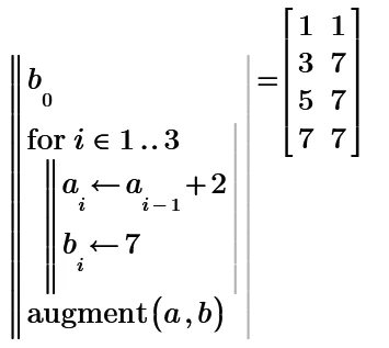

In your program "a" is local only for a sort moment. after the fist assignment which introduces the global "a" on the right hand side it turns into the global variable. As ttokoro showed, just "mentioning" b (his first program line) does the job as well. I am not sure if this behaviour is OK from a purists point of view. The "normal" way to do it used to be the dummy assignment  b <-- b.
