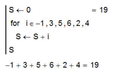

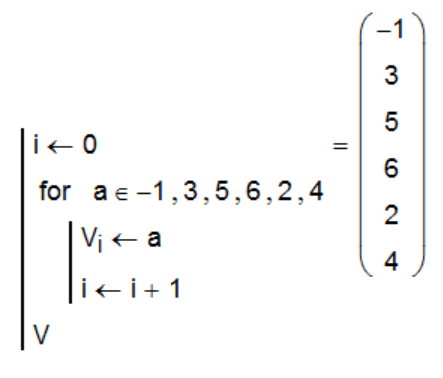

While we're waiting for Stuart's request to be finally implemented in Prime version N...
you don't necessarily need to program, if you can live with...Well it's basically what Fred described above:

Not as you. I have a long standing request to allow such a feature, including by extending the concept of a sequence to allow arbitrary lists of values, such as 1,2,3,5 or (1..3),5.  We can already do this in a programming for loop, so this change woukd mean we could do the same thing at worksheet level using the := operator.
Stuart

LucMeekes23-Emerald VAnswer
23-Emerald V
October 19, 2016
