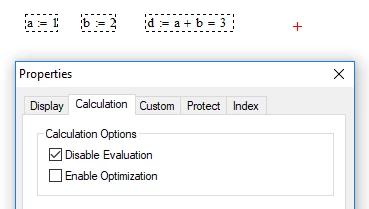

Thank you, but fortunately it`s possible to disable several regions at once.

Yes, it depends on the size of the area, the number of regions in that area, if its more comfortable to select them all and disable them or if its more convenient to simply move the collapsed area out of the way to effectively "disable" all regions inside.

Thats not disabling a whole area at once, but yes, thats exactly what ifimenko meant when he wrote "fortunately it`s possible to disable several regions at once."
