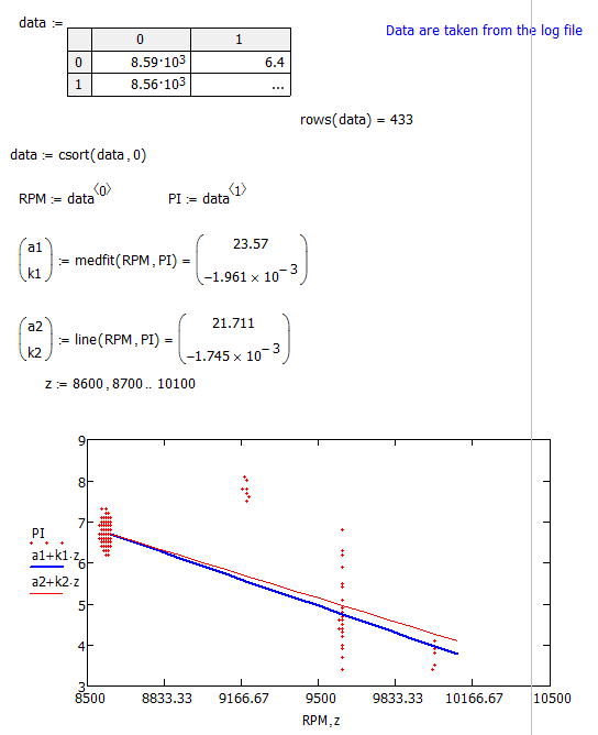

I think better to use medfit not line function
Are you looking for something like this:
BTW, you may also use line() instead of linefit. It may be more convenient to get slope and intercept.
WE

Werner_E25-Diamond IAnswer
Yes, you are right. I was too quickly glancing over your routine in my first attempt - sorry.
I was not taking into account, that you are looking for values inbetween two RPM values.
This should do the job, though:
Regards
Werner
EDIT: I changed the routine so that you don't have to call it twice later and showed how to use line() instead of linefit().
