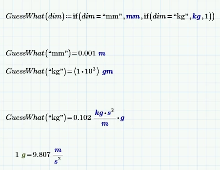

Mathcad 11 (or any other version since about 3 and before 12):
And Prime 4 (and I guess 1 to 3.1 as well):
So, apart from the stupidous gm instead of g, (who would ever get it into his mind to define the earth gravitational acceleration as a UNIT named g,  where at best it's a physical constant !?!) it works in almost all versions of Mathcad and Prime.... but unfortunately not the one you're using.
Maybe a reason to start using Prime, although there may be a ton of reasons not to...
23-Emerald V
October 18, 2017
Sorry, a correction is required here, it's even more weird:
So I have to put the unit gm instead of g to get plain grams.
If I put the unit g, Prime confuses it with the Earth gravitational acceleration (green) constant g...?
