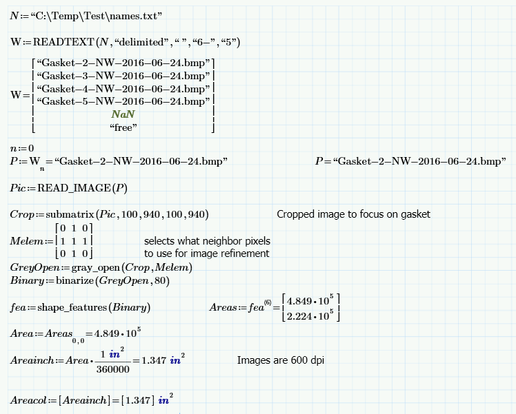

I have a bunch of images I would like analyzed for a specific "shape_feature".  I would prefer not to have to point to each one individually.  I would like to write a little program (in Mathcad) that points to a directory, does the image processing and gets the "shape_feature" I want and then goes to the next image in the directory.  I think I know how to do this except I don't know how to have Mathcad point to a directory and look at all the files in the directory.  Any help would be appreciated.
June 27, 2016
Hi Marcus.
With Mathcad 15 you can write a vbscript component. But I guess that is more easy to use a DOS command window with "dir *.jpg > names.txt", read "names.txt" into mathcad and use the string functions inside mathcad to recover the names.
Best regards.
Alvaro.

Hi Marcus.
Best regards.
Alvaro.

Thanks Alvaro for the insight,
I am using Mathcad Prime 3.1 and ideally I was hoping to keep everything in Mathcad but your suggestions may be workable for me.  Thanks for the suggestion.
Does anyone else have a potentially more direct suggestion?  Something that stays in Mathcad?

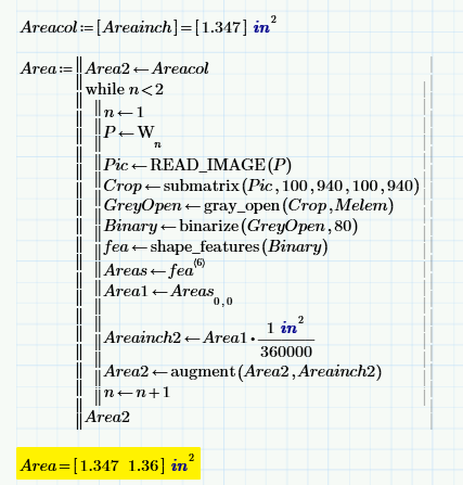

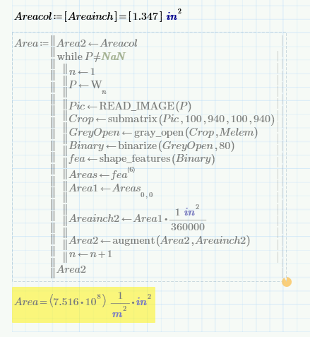

Ideally, what I want is to be able to point my Mathcad sheet to a directory full of images, it gives me the area of those images and compiles the different areas into a matrix.  I am very close to having this working but I have a programing error.  My program "Area" (in the worksheet) works as long as it only iterates once.  For example, if you change "while P does not equal NaN" to "while n<2" the program works.  I want the program to go through the list of files, getting the areas until "P equals NaN".  Can you see what is wrong with my program?  It is probably a silly error.  Thanks.
June 27, 2016
To compare a variable to NaN, you have to use the function IsNaN() -- you cannot compare directly.  In your case, you'll obviously need to use the logical "not" comparison as well.
I did not check your program for any other errors.
mepp1-VisitorAuthor
June 27, 2016
Thanks everyone.  I was able to get the Mathcad sheet working properly.  I appreciate the help.
