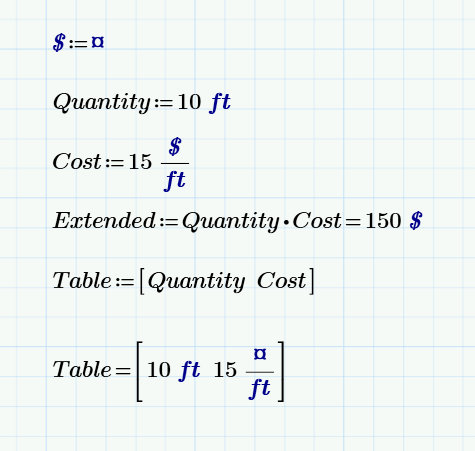

Maybe the attached helps?
Define $=square and make $ a unit should do it.
Yes, it does the job, but its a shame that its necessary to do so!

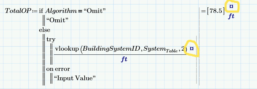

March 20, 2017
I'm doing something wrong.  I can define a unit, but Mathcad's not taking the $.  Is there another symbol for dollars (versus the keyboard) I should be using?

March 21, 2017
Thanks for everyone's help!
But is there a way to get a "$" as an output of a calculation versus the square as below?  I attached the file for reference.

March 21, 2017
MathCad defaults to certain units; the square must be one. If you change the unit to "$" in your result, the "$" unit should remain if you change the values of "a" or "b".

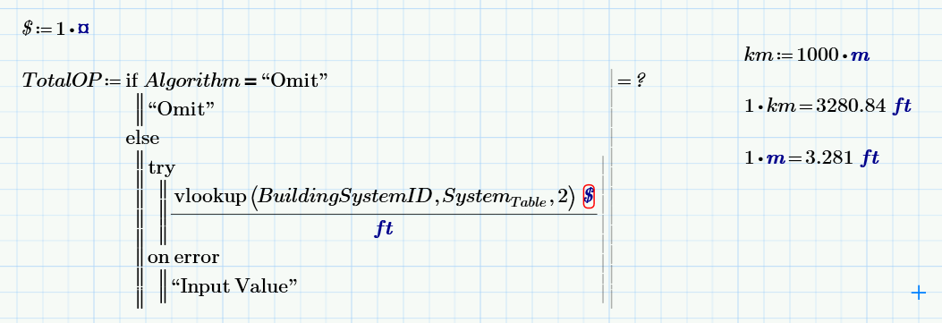

March 23, 2017
One more question.
I've changed the output unit to the '$', but my matrix keeps the 'square'.  Is it possible to format an element in a matrix so that it returns a '$' (see below)?

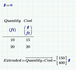

March 23, 2017
Unfortunately, you can't change the units in a matrix.
You could make a table:
March 23, 2017
Adding another row to a table...
