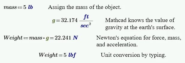

The best way I know to describe Mathcad is as an active hand-written sheet.
  • It looks like math.  EXCEL hides its formulas while Mathcad has them on full display.
  • It has many built-in constants.  In addition to pi (which EXCEL has) there are many.
  • Perhaps my most favorite feature: Mathcad knows units and converts.

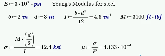

Another example:
Mathcad has the capability to perform complex calculations, display the results clearly, and present the analysis in a form that can be understood by anyone who knows math--no programming skills required.

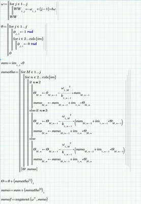

Apart from the benefits mentioned by Raiko and Fred, you can also do programming (if at all necessary). So in my opinion, Mathcad is definitely better than excel for performing design calculations and my favorite reason for choosing Mathcad over excel is that I do not need to take care of units as the unit system is already built inside the Mathcad system and I can get the output in any desired units.
