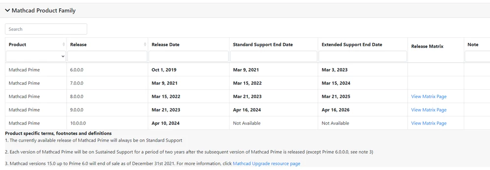

Is Mathcad Prime 7 still supported by PTC?
Hello, Please let me know if PTC still officially supports Mathcad Prime 7.
Is there any official PTC link where it is stated that this version of the Mathcad Prime software is officially supported?

login to support.ptc.com and go to https://support.ptc.com/cs/release-calendar/index.html?productFamilyIdList=24 page.

Hi Martin - Thanks for this response. This was exactly what I was looking for.
For those who might not have access to the PTC Support Portal, I have given below the Support dates for the Mathcad Prime software till date.
