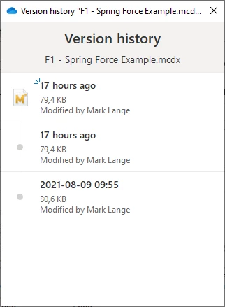

Is there a "file history" or "version history" in Mathcad Prime?
I am looking for a tool that allows me to access the edit or save history of a file in Mathcad Prime, much like what is found in Creo.
I cannot find what I am looking for in Mathcad Prime. Any clues?

Mathcad and Prime will store in each file:
- the version number of the file, that is how many times the file was saved.
- The creator (PC node/ user name)
- The modifier (PC node/user name)
... I remember seeing an extra information string in some cases.
I fail to find any location in the application to see or modify such information, but then: I'm limited to Express.
In the application you can have the save-date of the file in the header or the footer of the file.

Thank you everyone for your replies! With these explanations I found the Version History by using the RMB on the file in the File Explorer!
