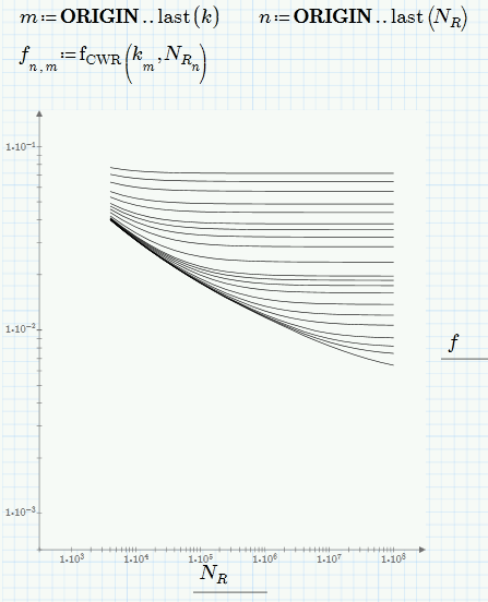

I am working on plotting my own Moody Diagram in Mathcad. I have done this in Excel and CurveExpert Pro, but now I want to do it Mathcad. Also, I am comparing various explicit approximations to CW for accuracy (I have already completed the smooth pipe analysis for k=0). For both tasks, I need an efficient way to solve CW over the ranges of k and NR. For example, I have a data set consisting of 21 values for k and 45 values for NR, which gives me 945 data points for f in 21 cuves (in the attached worksheet, I reduced the data set for NR to 23).
As you can see in the attached worksheet, I was able to solve CW. However, I am looking for a more efficient and more elegant method. I tried various combinations of subscripts, vectorize operations, etc. both inside and outside the solve block, but this is the best I was able to do. Any suggestions would be greatly appreciated.

May 15, 2014 8:25 PM UTC
How about the attached? In MC15 format I'm afraid as I don't have Prime 3.
Alan
Edit: Just realised that, if Prime 3 is like Prime 2, the 2D plotting won't be possible using the single friction factor variable in the way that is possible in MC15.
Werner_E25-Diamond IAnswer
May 15, 2014 9:00 PM UTC
If a 2D matrix is plotted the plot type in Prime 2 had to be set to waterfall plot explicitely to make it work the way we are used from older Mathcad. In Prime 3 waterfallplot is chosen automatically in that case.
May 15, 2014 8:53 PM UTC
Here is a bit late pretty much the same as Alan showed done in Prime with your data. MC15 plots just look better, though, and are much easier to format.

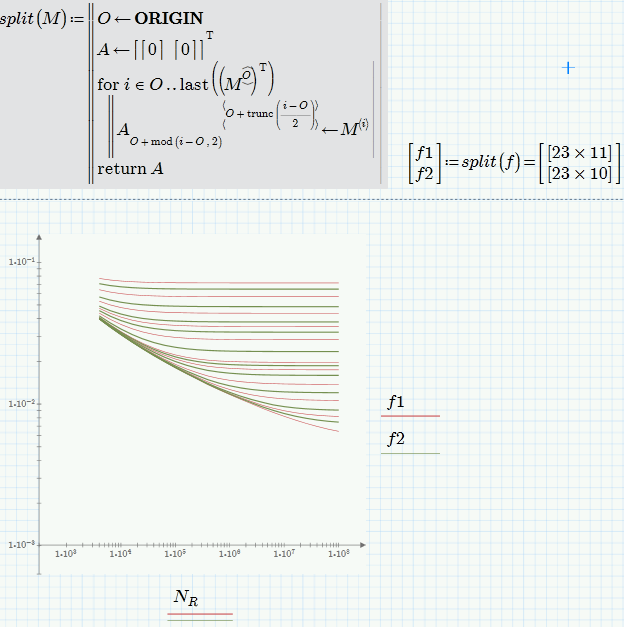

May 15, 2014 9:37 PM UTC
You are welcome.
In case you want to retain the alternating colors in your plot, you may consider using a routine to split the matrix f accordingly.
