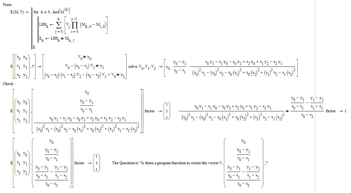

Is there a program function to create the vector V ...?
Hello Everyone.
From :
1.PNGThanks in advance.

Many thanks for your time and help, Valery and Luc. I think my question is not clear :
Regards.

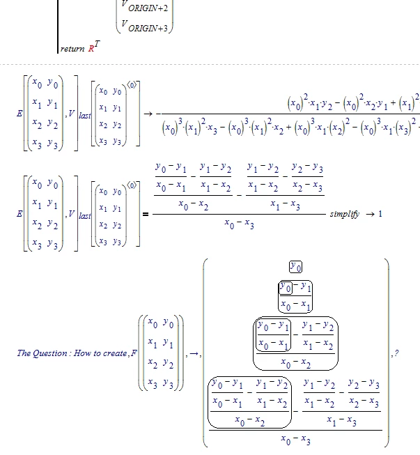

23-Emerald V
Feb 20, 2019 6:27 PM UTC
So, the vector created was OK , but it didn't show the way you like it... is that it?
In that case, let me tell you:
It is very hard to control the shape of output of the symbolic processor.
