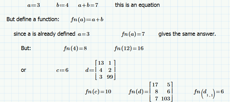

Not sure I understand what you're asking!  But Mathcad is pretty powerful:
Can you give an example?
