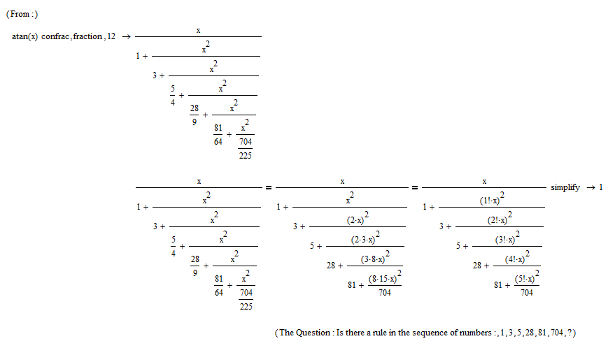

Is there a rule in the ( atan(x) confrac,fraction,12 ==> ) in Mathcad ?
  Hello, Everyone.

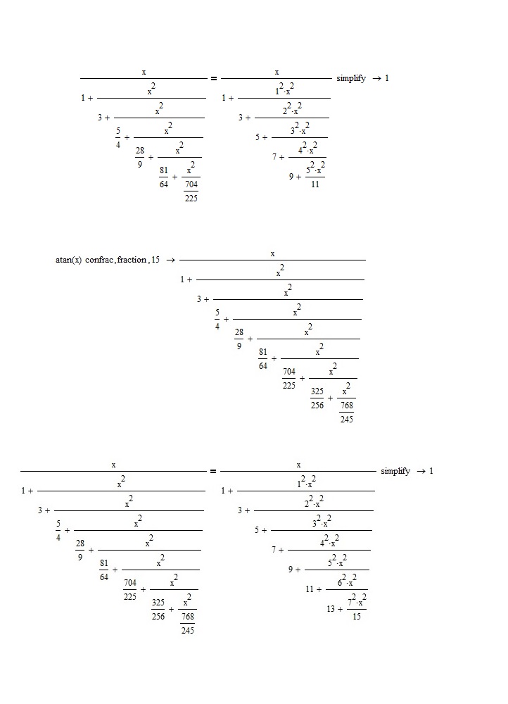

  The Question : Is there a rule in the sequence of numbers : 1, 3 , 5, 28, 81, 704  ?

  Oh... , Many thanks, P.M.
