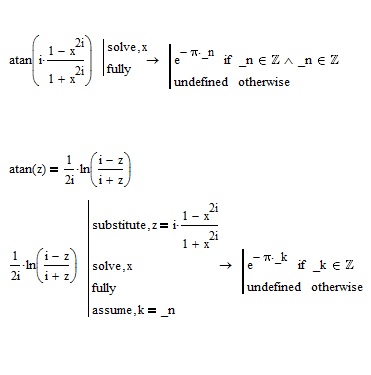

Is there a way : 1i^(-2i), symbolic, ==> e^Pi ?
   Hello, Everyone.
   From :
           Thanks in advance.
-MFra-Answer
January 24, 2017
....Only so:
-MFra-21-Topaz IIAnswer
January 24, 2017
....Only so:
