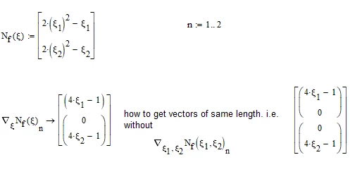

Is there a way to control the lenght of gradient vector
Hi, I want to get vectors of the same length. Is it possible to do this
Thanks in advance

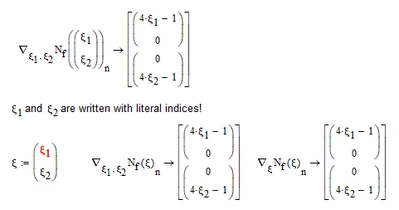

Werner_EAnswer
Here is a more general version of the above
Maybe that way, using literal indices

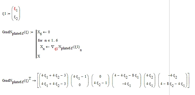

ifomenko1-VisitorAuthor
No, but you`ve given me a good idea

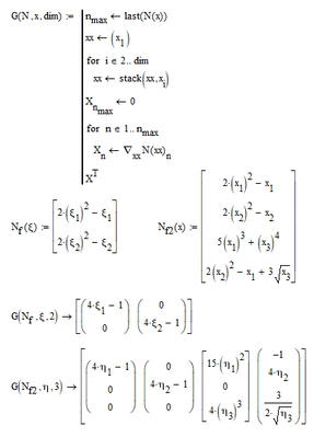

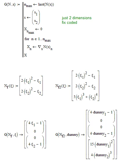

without literal indices
This function may be more versatile
