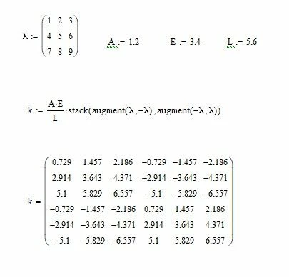

Is there a way to expand matrix with submatrices inside to single regular matrix?
I have this k_1 matrix
is there a way to expand this matrix to 6 by 6?

Like this perhaps:
This was done in MC15, but I expect it will work in Prime as well.

Like this perhaps:

Thank you very much! It worked!
