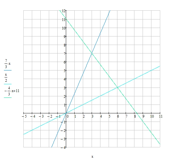

Is there a way to fill color for a triangle ?
   Hello Everyone.
   From :
   Many thanks for your time and help in advance.

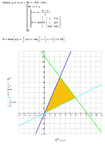

There is no built-in way to fill the area, but you can quickly write your own hatch function to create a number of vertical hatch lines between two functions:
MC15 sheet attached
BTW, I'm a bit irritated because I am not able to resize the plot region, making it smaller. Not sure why!?
Werner_E25-Diamond IAnswer
MC15 sheet attached

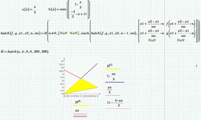

hatch for Express:
(Note that the first two arguments must be labelled as functions.
You may consider renaming your function to hatch_aux(f,g,...) and define
hatch(f,g,x1,x2,n):=hatch_aux(f,g,x1,x2,n,n)
That way you avoid having to provide the number of lines (n) twice.
