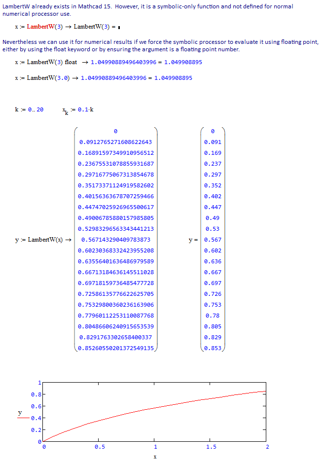

You can use the following built-in Mathcad functions:
  • LambertW(x) - Lambert's W function;
  • LambertW(n,x) - nth branch of Lambert's W function. Note that LambertW(x) = LambertW(0,x).

No problem, Walter.  Although I think Werner's solve block solution is probably a better route to go for repeated working within a worksheet (eg, for large vectors) as the symbolic solution occupies quite a bit of space (alternatively, put LambertW evaluations into an Area and hide the Area).
Stuart

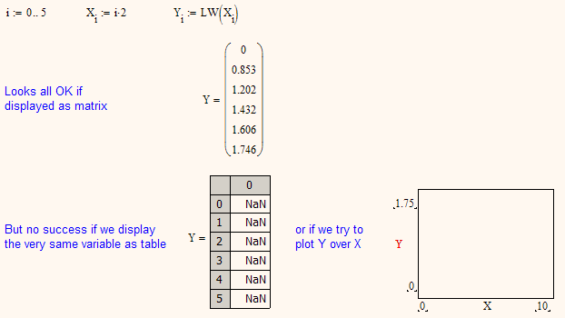

Is was already said that LambertW exists in Mathcad for symbolic evaluations and that we can use it for numeric evaluations in some way.
I remember threads a long time ago where it was tried to create true numeric functions based on functions which only are available in the  symbolics, like LambertW.
As far es I remember there was no real success as ever so often we would experience rather strange effects.
Here is one try which on first sight looks pretty OK
But trying to uses this function in a plot fails
On further investigation it gets really strange

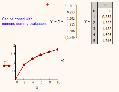

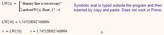

Sometimes there is a workaround using a dummy numeric eval, but its pretty clear, that LW() can't be used as a normal numeric function

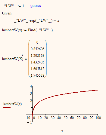

So I guess that it will be often the better choice to use a user written function like the one of Stuart you referred to.
Maybe even a solve block function would do the job in a satisfactory way (the following at least for arguments greater that -1/e so the result is real)
Werner

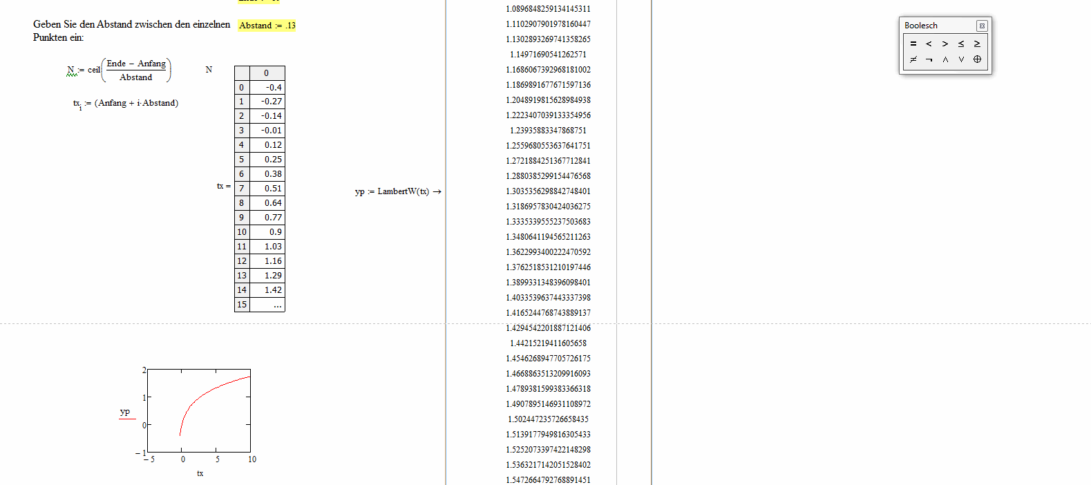

Dear Werner,
I really can not share your expericence. I did a normal Range Var and got right values. See: LambertW_Mathcad15.gif
May 25, 2016
Ok Werner, I saw you did a Y := here
That is what I did originately.
