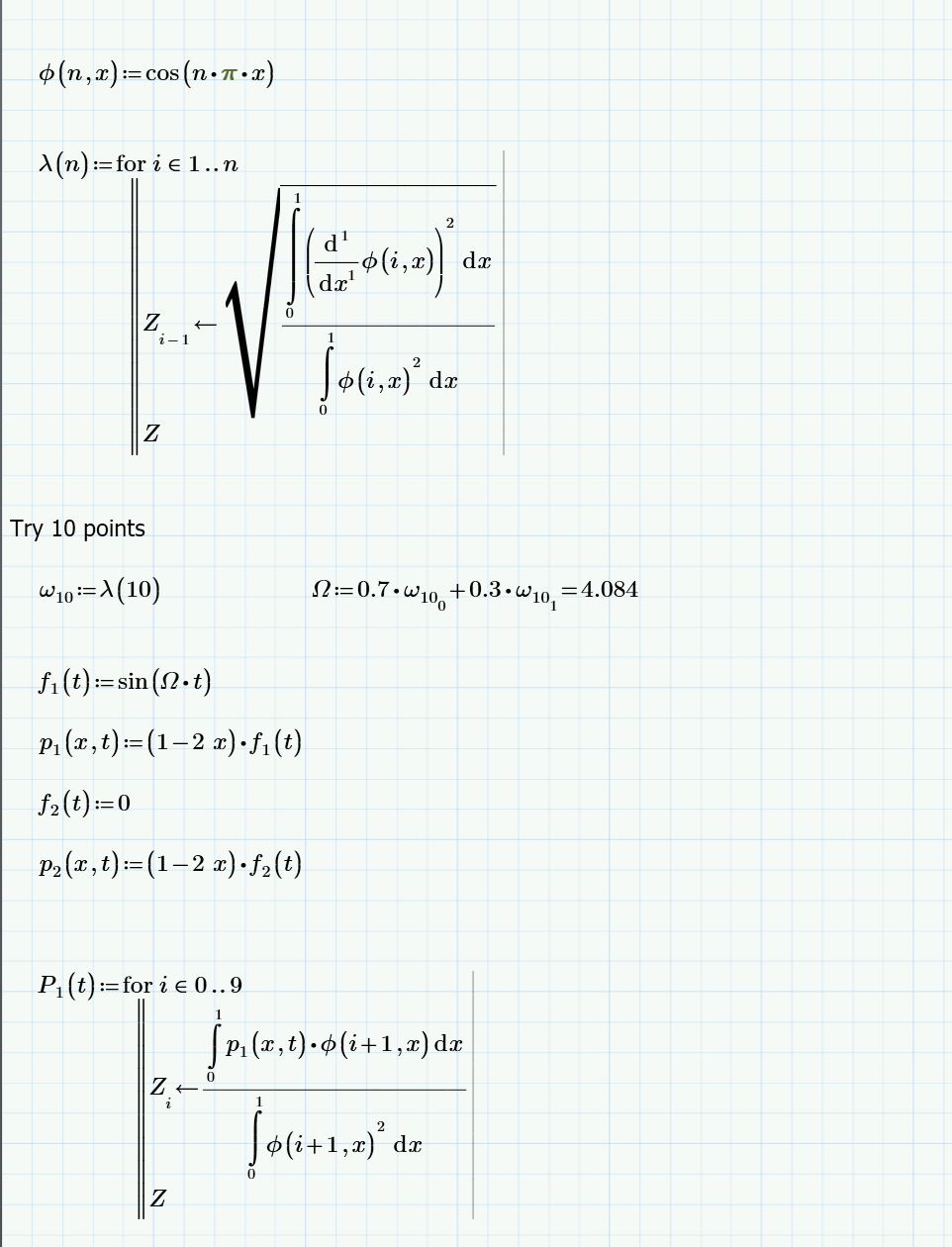

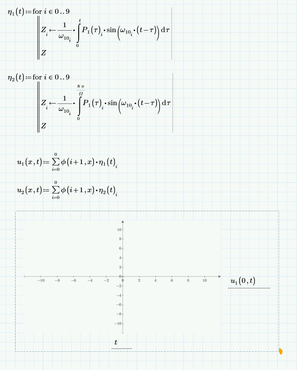

I am trying to use Duhamel Integral to calculate a continuous bar axial vibration response,
Below is my process:
I only used the eta1(t) part and the first phi*eta1(t) (add from i=0 to 0)
But it takes 5mins for Mathcad to finish the calculation of this simple case.
Is there a way to improve the calculation efficiency?

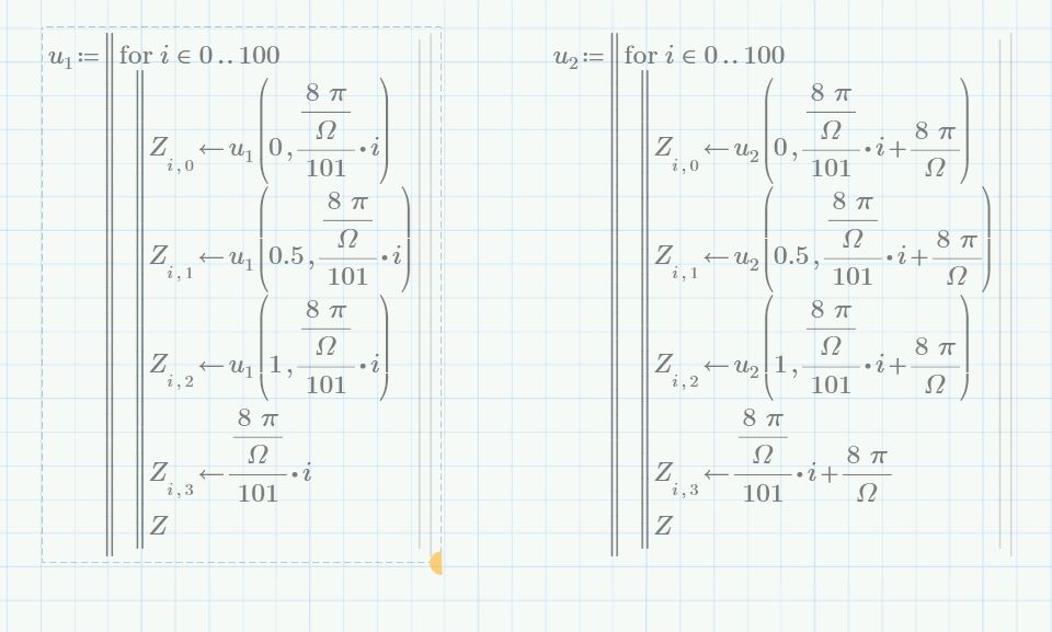

Before this, I also tried to create a matrix with 100 points for u1, and plot the matrix,
but the time for the final calculation is also very long.

I also tried this way, but it is also very slow.

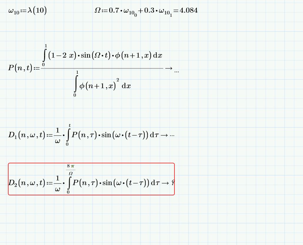

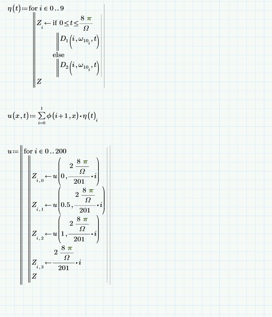

Hi, guys,
I tried this way, similar to Matlab, and it improved the efficiency a lot.
I just save the expression of Duhamel integral as a function, and substitute n, omega, t as variables to find eta.
With the expression saved beforehand, the later calculation is much more faster.
Hope this could help if anyone needs.
