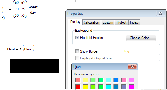

Right click on an equation , select properties then the protect tab.
un-tick the protect check box, and when you lock the file this equation can still be edited.
Note that properties such as the colour highlight can still be changed.
