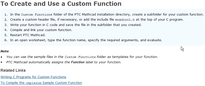

If you look in the "Custom Functions" folder in the installation directory of Prime, you see an example to implement your own custom function using C as programming language.
You find a little bit of information about custom functions in the help
but again - it will not help you learning how to use Primes worksheet level programming language.

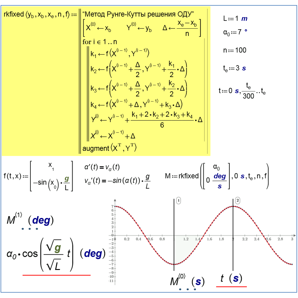

May 11, 2016

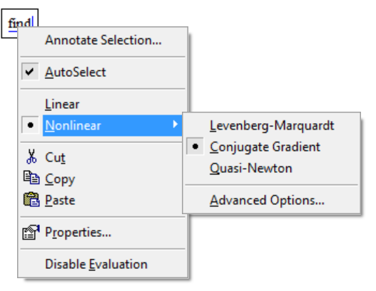

What function do you would like study?
See please in Mathcad 15 what is built in the find function
root function with 4  arguments
Video Link : 1468
root function with 2  arguments
Video Link : 1466
Rkfixed function
Etc

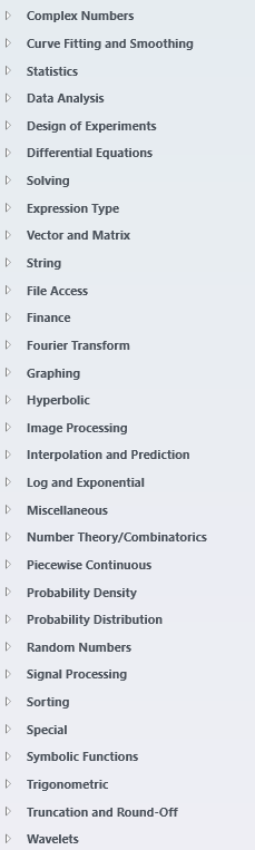

May 17, 2016
In the old "Mathcad 11 User's Guide" has been given a description of all built-in functions of the program with an specifying of algorithms is used in their and provides a reference links. See "Chapter 16 Functions" and "Appendix L: References" (for references details) in attached PDF.
