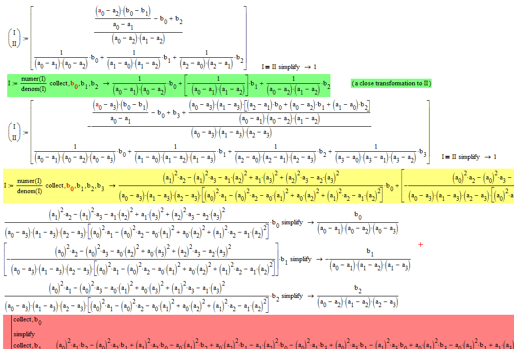

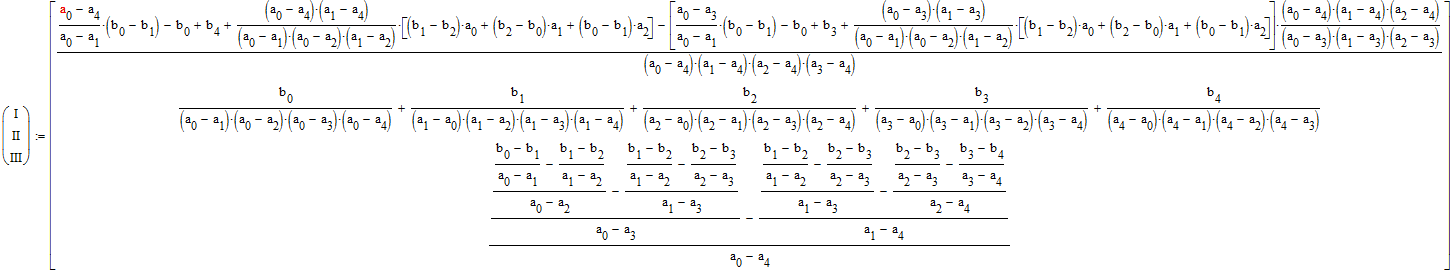

Hello, Everyone.
Is there a way to transform mutually fraction to fraction  ?
I can (messily) get the second form, but not the third form.
Stuart

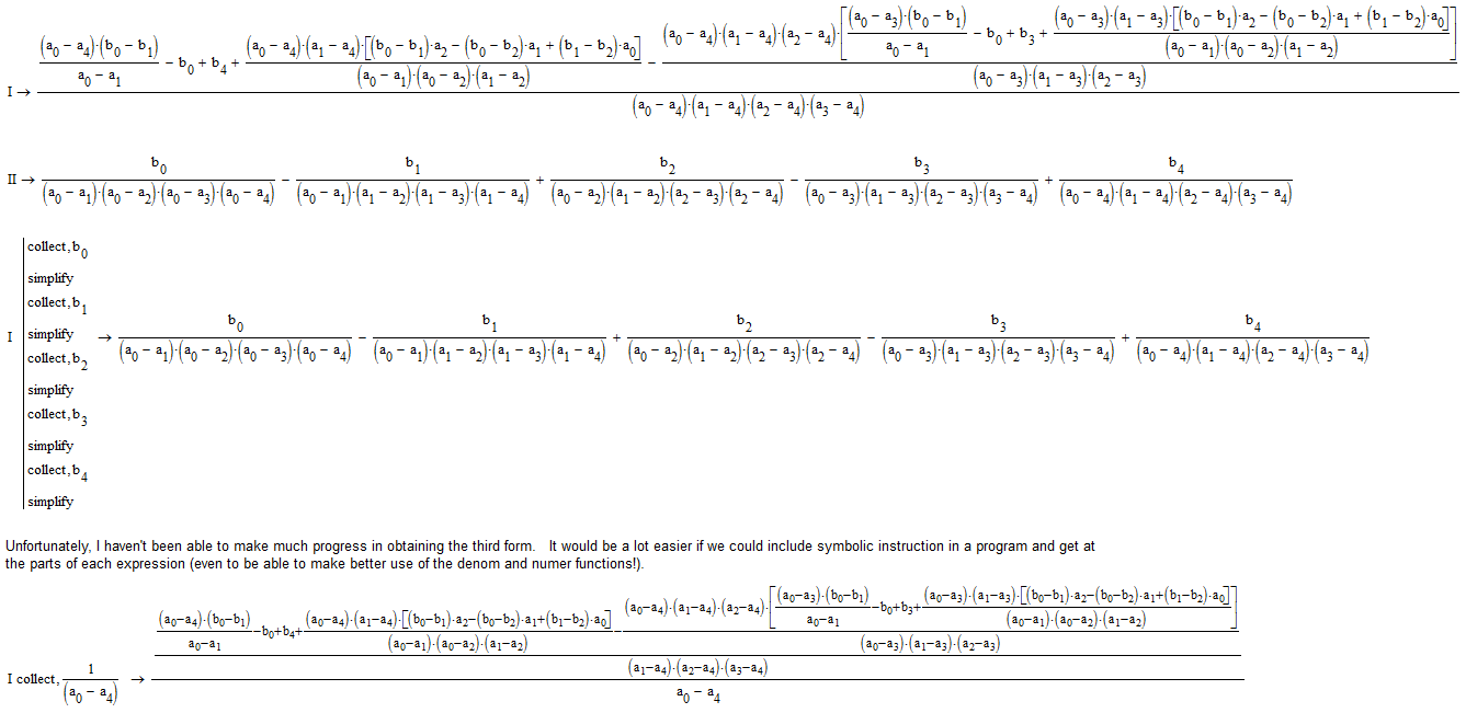

Loi Le wrote:
Hello, Everyone.
Stuart

  I greatly appreciate your time and help, Stuart. Many thanks for symbolic instruction ...
and the hint of using of denom( ) and numer( ) function. I'll try and see...
      Regards.
         Loi.
