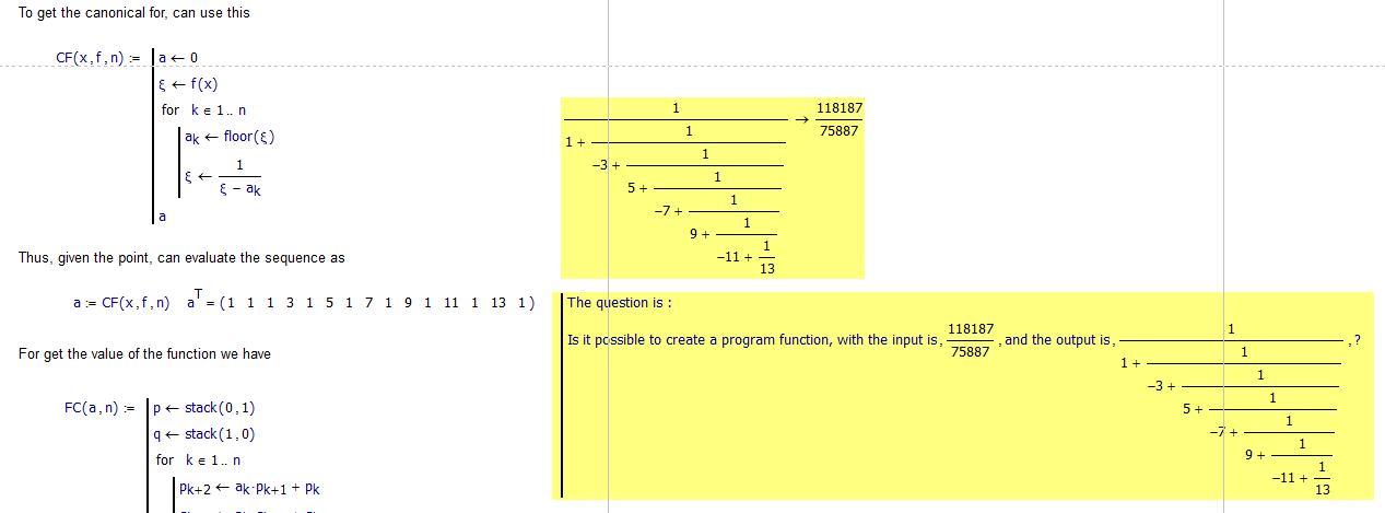

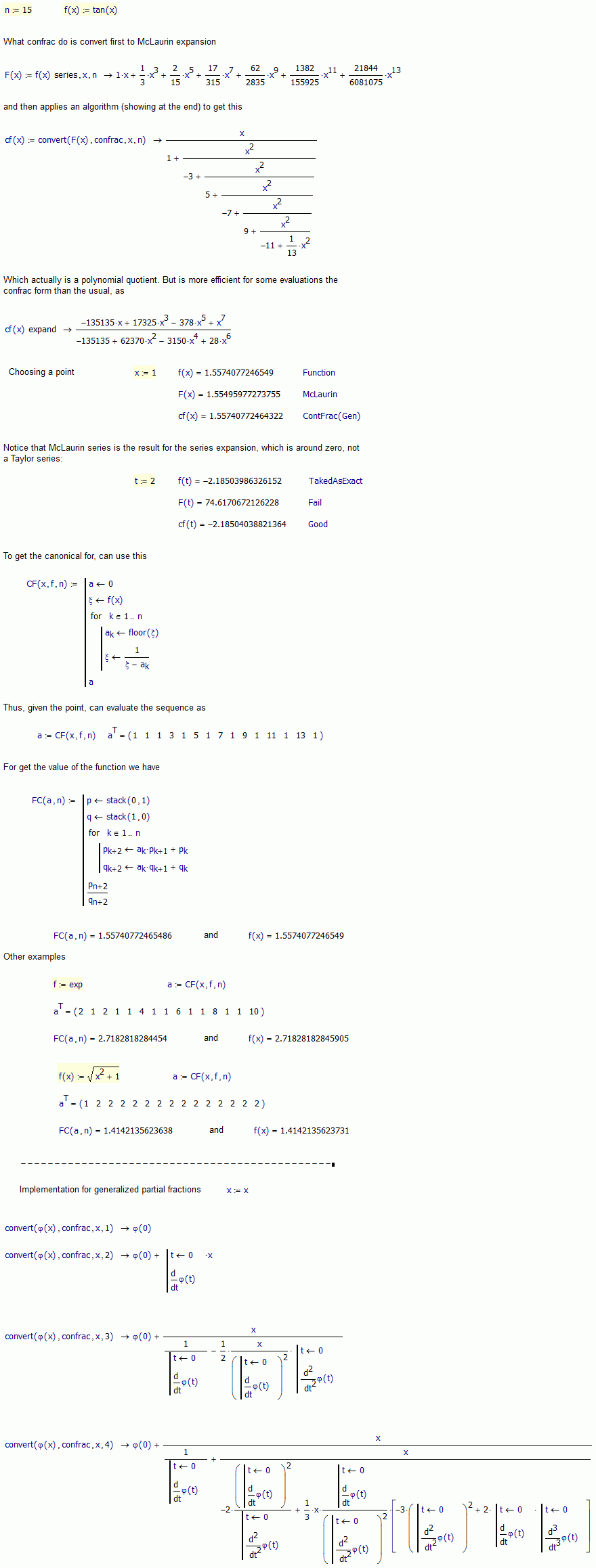

Here a way.
Regards.
lvl10720-TurquoiseAuthor
20-Turquoise
  I greatly appreciate your time and help, Alvaro.   And I have a similar question is :
  Is it possible to create a program function with the input and output like as the above or a similar ?
     Regards.
