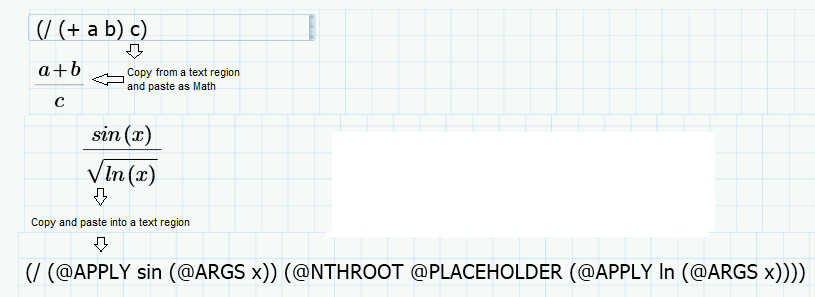

Is there any method or plugin could translate the expression between Mathcad and plain text?
During using Mathcad, sometime I need some functions that mathcad don't have, such as plot a complicated function or put it in a Geometry Software like Geogbra, then I must translate the mathcad expression manully.
And on the other hand, when I want to calculate some function from other programs in mathcad, I must translate the plain text expression into Mathcad expression.
For example:
It's very troublsome and time-consuming! Is there any method or plugin could translate the expression between Mathcad and the plain text easily?

Remember seeing somewhere a similar transformation from Mathcad. But where?
Jul 22, 2014 11:35 AM UTC
In Mathcad with Maple symbolic engine (Mathcad 11):
http://twtmas.mpei.ac.ru/mas/worksheets/F_X_Y_Plot.mcd
http://twtmas.mpei.ac.ru/mas/Worksheets/Solve_Symbolic.mcd
and with Polish notation in Mathcad Prime 1 and 2:
and in Mathcad PM http://communities.ptc.com/docs/DOC-2695

It seems that mathcad could insert math region into text region is also have disadvantages.
And the textbox is really a good thing! I hope you can provide the script of the textbox for me, Sir Ochkov.
