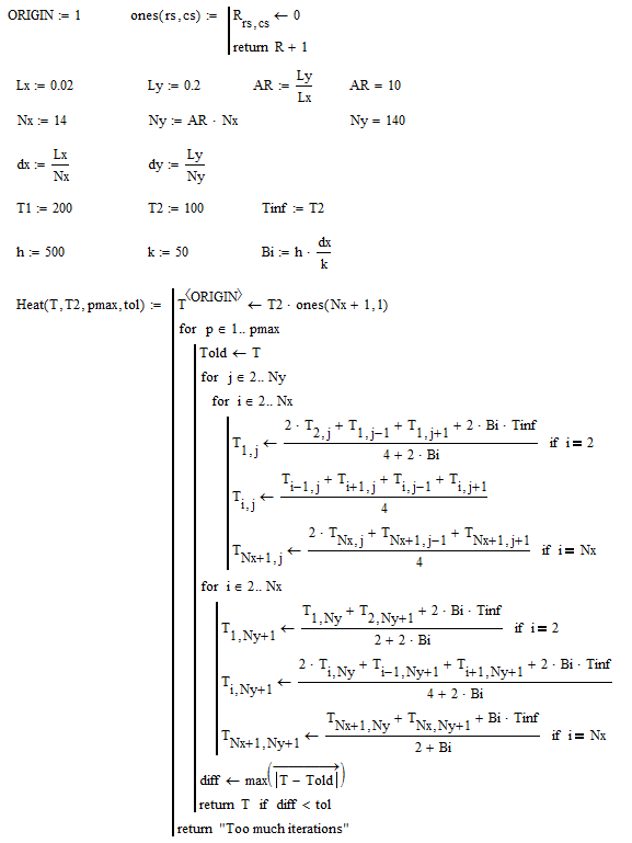

This would be a translation of the Matlab script, into a function for Mathcad:

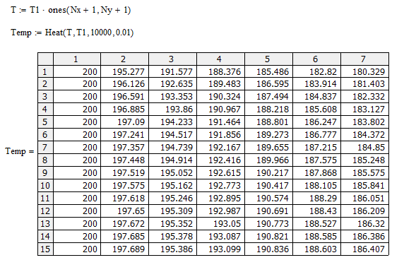

Then, with the definition of an initial temperature profile T, we get the following result:

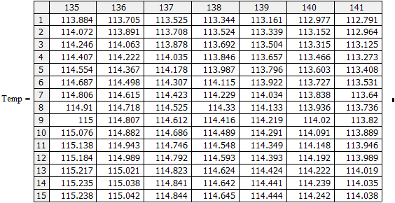

Which stretches out to the 141'th column:

Considering you have Prime 2, you should have Mathcad 15 installed, so you can open the attached Mathcad 11 file, save it as Mathcad 15 file and then convert it to your Prime from within Prime.
{corrected attachment}

There may be an error in my translation (Matlab to MathCad), or the Matlab script algorithm isn't right, but I expect a symmetrical solution for such a symmetrical problem.
