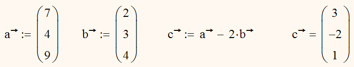

According the display of vector variable names I don't know of a way to create that arrow above the name. The best I could achieve using U-20D7 from charmap is an arrow after the name
which doesn't look that good and is awkqard to create. So I guess that the bold typeface suggested by Alan is the better alternative.
Werner

Just looks horrible, that's playing with Ctrl-Shift-K and J. Like Werner, believe that black notation like Alan's or F.M. is better.
I don't like it, too. But its a clever idea and a new use for the vectorization operator.
I guess the only way to get a decent vector notation is to use a modified font. Either modify one of the diacritc symbols to look like an arrow or create a font with an arrow over each letter. The the sheet won't be compatible with anything but for documentation this might be an option.
Sure too much hassle for me - I would stay with normal or bold typeface.
