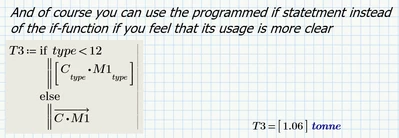

I see no need for any variable "j" - neither as a range, nor as a vector.
You may use the if-function:
Note that you need to apply vectorization when calculating C*M1.

and of course you don't have to use the if-function, you can also use the programmed if-statement
Prime 9 worksheet attached
