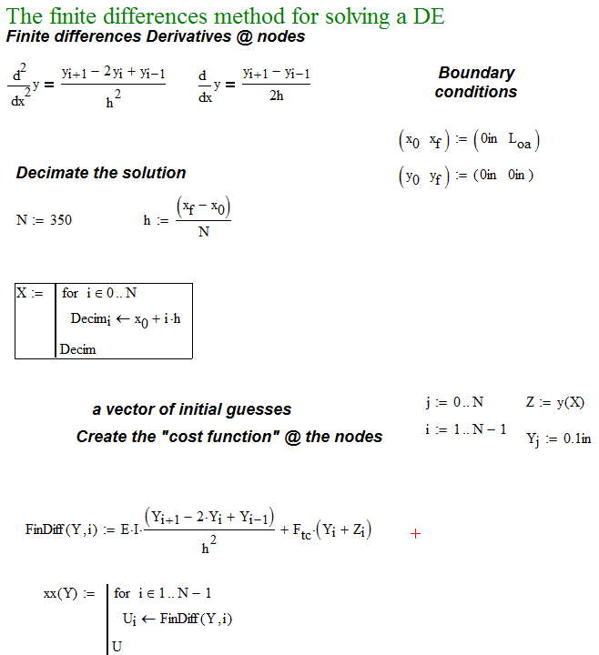

October 19, 2015
Attached is an example of a finite difference solution to a differential equation.  You develop vectors for the parameters you are solving for, and assign guess values.  (You need a vector of X (nodes along your pipe), and Vectors for H and V that specify values at each node.  (starting guesses are not terribly critical, they can be constant values in all cells.)  You then create a cost function (basically your "C" algorithms) that define the relationships.  A solve block is used to find the values that solve the cost function.  The solution then plots the vector values along the nodes.
As for "invalid indices:
  • A vector needs only one index, so H sub i,j has one too many indices.
  • By default Mathcad starts indices at 0.  You may change this with the built-in variable "ORIGIN"
Good luck!

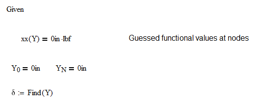

If you want to use j as a time index you need to set it up that way.  You need to set up H and V as arrays (with I rows and j columns) then write your cost functions as functions of arrays H and V and indices I and j.
Excerpted from the file you couldn't open:
The Given/Find construct is a "solve block."  Mathcad will (if things go well) find the values of Y that satisfy the constraints.  (Go read the help for solve blocks.)
This is a challenging problem.  Might be a good idea to explore some of the examples in the help files to understand better what you're trying to do.
