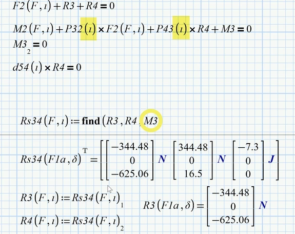

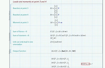

I'm struggling with a function within a solve block that requires two inputs, a force and an angle as shown below
So when I evaluate R3(F1a,_delta_) I get the error that it must be a 3 element vector. I'm pretty sure my mistake is simple, but I just can not work it out.

The reason for the error you see is because in your second equation you are using the just the function names P32 and P43 where you should use a 3x1 vector.
My guess is that you just forgot the function arguments.
M3 in the "find" function was wrongly labelled "System" but its label automatically changes to "Variable" as soon as you add the two function arguments.

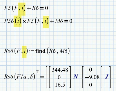

But maybe Terry is right when he guessed that you meant P320 and P430 instead of P32 and P43? You have to decide...
In the solve block which follows it looks that you are missing the angle argument completely. Maybe this is a correct fix?
Haven't looked further at the next failing solve block but I guess there are similar errors.

Got all the solve blocks to work but cannot guarantee accuracy.

Hi Werner and Terry,
Thanks for the help. Yes I had forgotten the function arguments in there. I thought I had covered them all but obviously not.
Thanks Again
