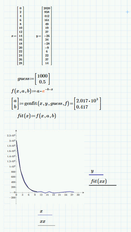

My assignment requires me to use genfit to fit this plot. However, it keeps saying that the variable "y" needs to be defined as a vector of real numbers, which it is. Not sure why it keeps saying this error and I do not know what to do. Any suggestions? I believe it may be a issue with the software.

I think the problem is in your formulation.  I didn't spend too much time with it but your use of z doesn't look correct.  Here's a simple version.  Although I did need to give it a good guess to get the right answer.

You have indeed a vector of data, stored under the variable name 'y'. But then, before the genfit statement, you also define a function y(z)...
Which 'y' do you think Prime wants to use in the genfit?
Renaming the function y(z) to f(z) or something else (but NOT y), might already solve your problem.
